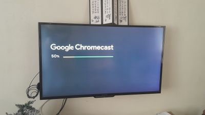

And why does my tv come on automatically, and I guess we have to leave ut in the tv to update?
