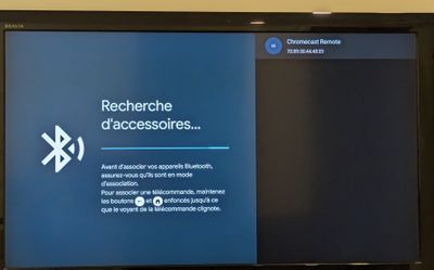

I am unable to use my google TV remote. It was working fine for the last year. Google TV is working fine (I can use my Pixel as a remote, we are able to cast from our phones etc) but remote won't work. It was configured to control my receiver, and this is not working anymore either.
Tried so far:
1.remove remote from google tv and pair it again. It will show up in the upper right corner with its mac address but eventually disappear.
2. Brand new batteries, with a factory reset for the remote (remove battery, hold "home" button, reinsert battery and release home button until led goes from solid to pulsing).
3. Restart the chrome cast.
Nothing works so far... Anyone?

Hello Jennifer
Unfortunately option 1. Didn't work. I wasn't able to pair the remote so I erased it from the Google TV settings, and since it's not there anymore I wasn't able to check for updates. When I first encountered the issues I've noticed that the update failed but wasn't able to force the update.
Option 2 (factory reset) seems to be working, but I was avoiding that solution since I need to reinstall my applications and logins infos on the GoogleTV.
But hey, problem is solved. Thank you!
