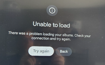

But with all our our Chromecast with Google TV (4K) and Google TV Streamer devices, it keeps trying to load Google Photos and then says:
Unable to load
There was a problem loading your albums. Check your
connection and try again.
Screenshot:
My connection is fine. On the Google TV Streamer and one of the Chromecasts, I am connected via Ethernet and on the other Chromecast, I am connected via wi-fi.
I tried switching over to wi-fi on the Streamer, but same error.
I should also note that, when this issue first occurred, when trying to reconnect Google Photos to the Google TV Streamer, I was prompted to enter my Google password. After doing so, I was prompted to create a PIN using the remote. So, I did this. Now, everything I am trying to change my wallpaper/ambient mode to Google Photos, I am prompted for this PIN - right after I successfully enter it, I get the "Unable to load" error.

Okay, I FINALLY figured out how to get all photos to display again.
DISCLAIMER
BACKGROUND
Here's the background/preconditions to my scenario
WHAT I DID ON DEC 31,2024 THAT RESOLVED THE ISSUE
Here's a visual of the setting that was "Off" for my spouse when in the Ambient mode "Google Photos" setting as a member of my Google Home:
Now, the same Toddler album still works on my sister-in-law's Chromecast and her parent's Chromecast. The commonality there is that both my sister-in-law and their mother are also members of the Google Family Plan, but my spouse is not a member of their Google Home.
CONSLUSION
It looks like some additional setting/permission was set up where all Google Home members need to enable a setting before any pictures in their Google Photos can be displayed on a screen in the home. I believe this to be the case because the pictures still display fine in other homes that the photo owner is not a member of, but has shared the album with some who is in the home (a gap, perhaps).
That was not fun to figure out.
