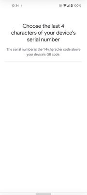

I'm able to enter the Key but the next screen in the Google Home App and the Nest App asking for the last 4 digits of the serial number will not accept the information.   Tapping anywhere on either of those screens does not produce a space and the keyboard.
I've uninstalled both apps and reinstalled them, I've cleared the cache in the Google Home App and still not
able to enter the last 4 digits of the Nest Thermostat serial number.  PLEASE TELL ME THERE'S A FIX

KlVOtgVTMa
Oh my god. I'm not sure to be frustrated or relieved that I'm not the only one w/ this problem. This is the screen in question:
 My only solution was to re-add the thermostat in the Nest app and then have it propagate to the Home App.

nict
Just come off chat with support. here's the fix that worked:
1. REMOVE thermostat from Nest app
2. Go to Settings in the Google Home App> press on Add Device>New Device (press Next) > It will say "Looking for devices" > Select Thermostat > Select Thermostat > Other Nest Thermostats (make sure you choose other) > Go to Nest App
3. Add thermostat using QR code or Entry key
4. Go BACK to GH app, then back again
5. thermostat now appears in GH app, and also in Nest app
