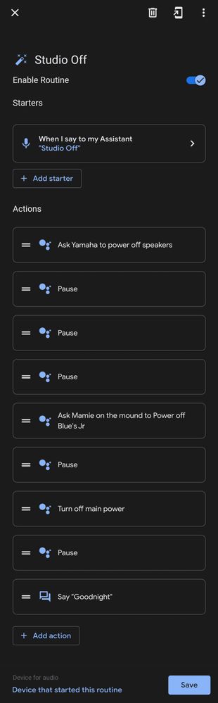

Last thing, I promise. If you have a custom routine and you use the "delay start" action, the next audible action, whether  it be assistant saying something or music you asked to play, you can specify what device the audio is routed to by pressing the little button circle below
Try setting up your routine like I have below. To make the pause actions, add action ---> try adding your own ---> type pause ---> done

So I guess you didn't read my reply yesterday about using Pause (see below). As I explained in that reply, Every time the routing encounters "Pause" my phone says "OK, for that you can talk to Maimie on the mound . Does that sound good?" I tap "no" and then it does it again for the next Pause. The pause command is not working for me as it apparently does for you.

stevegunderson
Regarding Step 4
I have similar custom delayed routines and I tried the "count to 3" action and it never worked right.
So Instead of trying to delay it by counting to seven out loud, replace the action using, "try using your own" and just type "Pause". This will work as a one second delay. So for yours create 7 "Pause" actions then move forward.  I've found this approach to be much more consistent with my routines that require delays. Hope this helps
I tried the pause function but each time pause is encountered it says "OK for that you can talk to Mamie on the mound. Does that sound good" I answer no and then it asks me again. After the last pause it does nothing.
I can't help but notice that your assistant is trying to ask Mamie Peanut Johnson to help you with your task. I used the routine from my last post and changed the devices to my ambient lighting which is named "Apollo" and my Xbox Series X named "DMX" and it worked flawlessly and without trying to talk with a baseball player from 1953. Create a fresh routine from scratch on your phone in the assistant routines section named Off Studio (<---make sure you don't have the same command for multiple routines while your at it). Do not use the Home app to create the routine. After saving open Home app and make sure your devices are named "Yamaha Speakers" and "Blue's Jr" and "Main Power" and run the routine. From the results your getting It seems like you may have have two different apps of services linked to the routine that can't run simultaneously. Like the Yamaha speakers may be controlled from Yamaha and Blues Jr. by "Mamie on the mound" on the mound. So if creating a brand new routine doesn't fix it the last option you have is to create a routine on your phone with a unique name and if the devices are linked to 2 different services then you routine should look similar to the set up below.
