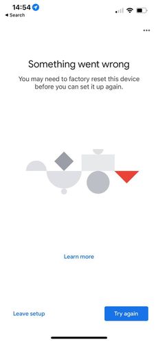

Hello,
My Google Nest Thermostat product do not show up in the Google Home app.
The issue is when I try and add the Nest devices to my Google Home app (via the 'Works with Google' option), when I select Nest it takes me to a login screen, but I have no login for Nest because I use my Google Home account for this. Trying my Google login doesn't work because this option does not exist. Trying 'forgot my password' doesn't work (no link is sent to my email).
When trying to add it in the Google Home app with Set up device -> New device (instead of 'Works with Google') it opens the Nest app. Manual adding fails with "Something went wrong". Both the QR code and ID code do not add my Thermostat in Google Home.
The Nest protect is working and is connected to the Nest app. However, I am not able to have my Google Nest Thermostat in my Google Home app, nor control it with voice control.
Evidence:
krabbedoelie
Solution:
Remove the Nest Thermostat from the Nest app
Go to Google Home: Add device > New device > Select the correct structure > Next >Thermostat > Other Nest Thermostats > Now it redirects you to the Nest App finally.
Next -> Add the Thermostat and to get the Entry key from the display of the Thermostat

krabbedoelie
Solution:
