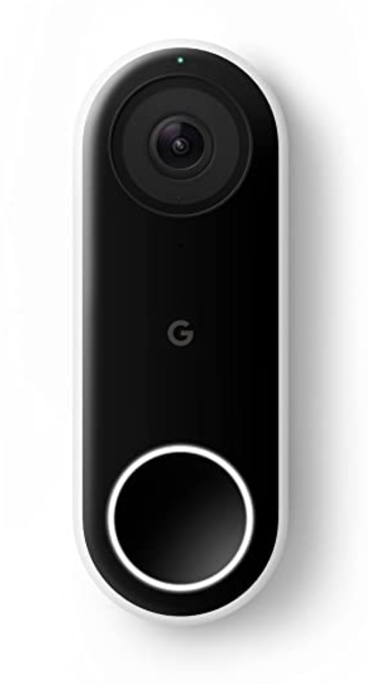

The Google Nest Hello Doorbell (black only) gets installed in the Google Nest app.
Google Nest Hello DoorbellGoogle Nest Hello Doorbell

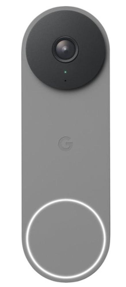

The 2nd Gen Google Nest Doorbell (wired) (several colors, and it's larger) gets installed in the Google Home app.
2nd Gen Google Nest Doorbell2nd Gen Google Nest Doorbell
