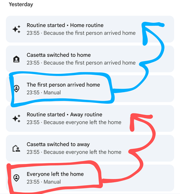

The AT HOME  and AWAY routines are not working properly all of a sudden.
The AWAY routine is set to turn on the camera when all phones leave the house.
The AT HOME routine is set to to turn off the camera when first phone reaches home: this is not working
YESTERDAY all was working
TODAY all is PARTIALLY working:
 What is  strange is also that
- when I left home the phone was detected outside correctly, no AWAY routine was launched BUT camera still was turned on
- when I returned home the phone was detected at home, no AT HOME routine was launched and camera remained on (I had to turn it off manually)
NOTHING HAS CHANGED SINCE YESTERDAY, NO NEW APPS HAVE BEEN INSTALLED.

I have also started to have issues with Home/Away this week. If I look at the "Activity history", everything is correct. It has my phone coming home and says it's switched to home. However, it actually stays on "Away". Sometimes it switches to Home hours later. As others have said, this is definitely a server side issue. If there was an issue with it not detecting my phone, the Activity history wouldn't show anything either. There is no reason it should say "Home set by Home/Away assist" but still be "Away" unless there is a bug on their side.

Today I checked and it said "Home" even though I had been out a couple of hours. The "Activity history" showed it had supposedly switched to Away as it should.
So, I tried to set it "Away" manually in the app. It just hung spinning away for ages. I closed the App, re-opened it, and it said I was Home. I selected Away again and left it, and eventually (maybe two or three minutes) it switched to Away finally. Therefore I conclude that the issue is with the Nest servers not readily switching between Home and Away. I expect Home/Away assist has a timeout and that's why it is failing, even though the history said it has switched as expected.

The last few weeks they are failing to comply with my home/away routines. In activity I can clearly see the home/away routine is being triggered correctly.
