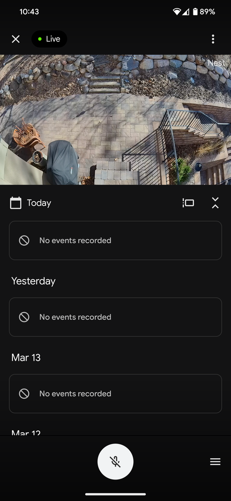

I have a number of Google Nest Cameras (6) and Doorbells (3), plus one Floodlight.
Everything seems to be working correctly - I can access all of my cameras/doorbells and stream live video and get notifications when an Event is captured.
Recently, however, I started getting 2-3 push notifications from Google Home per day with message: Camera is not getting enough power ... from my outdoor camera + floodlight combo. I climbed up on the ladder, removed the camera, and cleaned the contact points on the cable and on the camera (which looked fine).
The floodlight is working just fine, as is the camera, and I can see that the battery settings show it is plugged in and charging. No issues, except for the constant push notifications. See the attached screenshots.
Do I need to reset / reinstall the camera into Google Home? Is this camera defective? If it really was a power issue, wouldn't the floodlight not work and/or wouldn't the camera run out of battery?
Not sure what else to try, but would love to stop getting hammered with these specific notifications.
