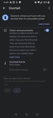

You can see from the picture attached that:
1. There is a message saying "electronic chimes won't work with your doorbell when it's using battery power" so wondering if that's part of the problem?
2. The option for ringing the indoor chime is greyed out.
@Clo
This screen seems to be causing lots of confusion, judging from other posts.
If your doorbell is not wired, then of course an electronic doorbell chime won't work because there's no wiring connecting it to the doorbell. A mechanical doorbell chime also won't work for the same reason. It's poor wording on Google Nest's part.
The "Ring doorbell chime" option is apparently disabled and grayed out by Google Nest for the same reason; if the doorbell is not wired to your indoor doorbell chime, it makes no sense to try to turn it on.
