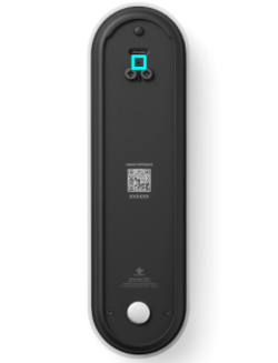

  1. Locate the reset pinhole on the back of the doorbell.
    Tip: The reset pin on the Nest Doorbell (battery) is located below the USB port on the back of the doorbell.
  2. Insert and hold the pin (you can use an unfolded paperclip or a thumbtack):
    1. At 10 seconds, the status light will blink yellow four times, and you'll hear a countdown tone.
    2. At 12 seconds, the status light will be steady, solid yellow while the doorbell starts the factory reset, and you'll hear a confirmation tone.
    3. Note: It may take more than 12 seconds, you need to keep pressing until the chime stops.
  3. Release the button. Your doorbell will restore to its factory settings.
  2. Press and hold for 5 seconds.
  3. Your doorbell will restart, and the status light will be steady and solid white.
