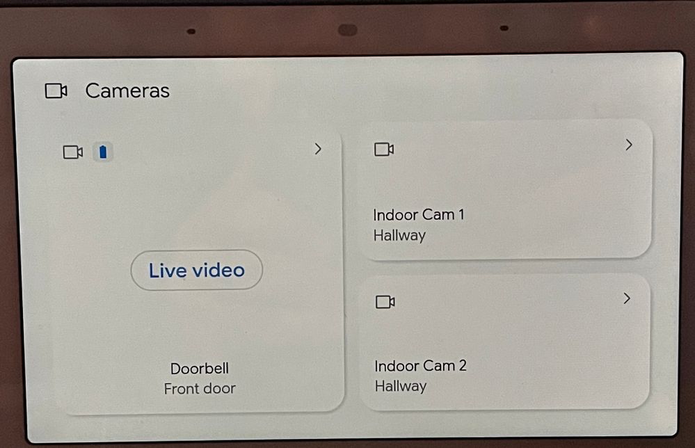

I go to Home Control > Cameras:Screenshot at Jan 20 07-33-11.jpgThen I click the tile (Doorbell), not on "Live video" but anywhere on tile and I see this (note that nowhere is shown it's wired like the home app on my tablets and phones show, no sign that battery is charging etc.):Screenshot at Jan 20 07-33-47.jpgAnd this is what I see in Google Home app:
@ChochoD
That's interesting. With our battery camera plugged in with the optional power cable, we get just the standard tile, not the one with a "Live video" button in the middle, and when we select it, it goes directly to the live feed. Maybe it's because the battery doorbell always runs off of the battery, even when it is wired.
