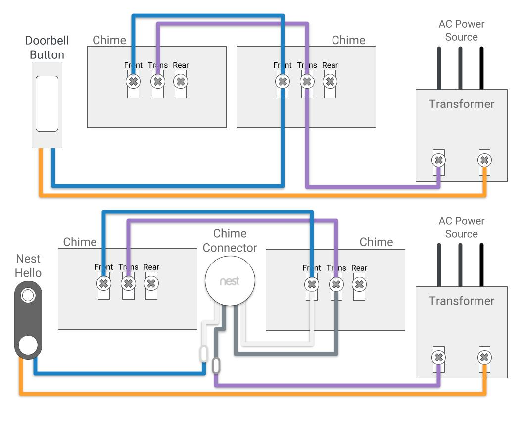

I had the Original Nest Hello until the battery died and it no longer will ring or send me an alert when the button is pushed.
SO I bought the new one. However NOW My Chimes do not work.
Note I was able to get it to work years ago by following the below diagram for the Nest Hello (V1)
https://www.googlenestcommunity.com/t5/image/serverpage/image-id/1854i21A250209EBC7BAB/image-dimensi...
Yes I did take out the old Puck for the New chime. (I touch the wires and it chimes)
Anyone have a wiring diagram for 2 Chime, 1 Doorbell with Transformer?
TLDR: 1 Doorbell, 2 Chimes, the chime will not ring when doorbell button is pressed.
