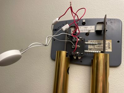

Hi. I’m having an issue where my mechanical chime doesn’t operate at all with the Nest Wired doorbell. I’ve included a photo of my wiring. The Transformer terminal has two wires. Regardless of whether I use either or both wires going into the puck, the chime does not operate. The Nest doorbell operates as it should. I have indoor chime settings in the app set correctly to no avail. Any ideas?

I think the doorbells work best on 24v  Despite what they say, I don't think 16v is enough to power the doorbell and ring your chime.

 Think it’s very likely the transformer isn’t supplying enough voltage to operate both simultaneously. I discovered my lighted house numbers are lit by the doorbell transformer and this may be my issue as well.

I can't tell from your photo whether your wiring is correct, but some customers in this forum (including myself) have gotten their mechanical chime to work by going into Settings for the doorbell, selecting "Chime duration", and turning the "electronic chime" option on and then off again. It seems odd that that should work, but it did for us and others.
I had read this truck, but it didn’t work for me. My doorbell transformer also powers the house number lights. When the Nest is installed I realized the lights were flickering or going out intermittently so I think there’s just not enough juice to power everything at once.
@Avanlaar
I don't have enough knowledge to know whether the fact that your house numbers are powered by the same transformer is an obstacle. The Chime Connector is supposed to provide continuous power to the doorbell's camera without tripping the chime. It's supposed to be wired as shown in this diagram, but the diagram doesn't take into account something like your house numbers. If the house numbers end up getting powered through the Chime Connector, that would seem to be a problem.

I've seen several posts in this forum where customers have had problems with the "chime puck" that comes with the 2nd gen Google Nest Doorbell. Some have even reported their chime works WITHOUT the "chime puck" and does NOT work WITH the "chime puck". A few have had success with a replacement "chime puck".
Yes, you help me in another thread. I removed the puck and everything works. Just still annoyed with Google and their lack of concern or support of this issue. They should send me a replacement puck but refuse to do it.

I have the same situation. 2nd gen wired with mechanical chime and 19v output from transformer. Everything I read says the chime connector MUST be installed, but no matter which app settings I select, installing the 2-wire chime connector suppresses the ringing of the mechanical chime. When I remove the chime connector, everything works fine, no issues of insufficient power. I've decided to simply leave the chime connector disconnected based testing all possible options.

Other customers, who can't get Google Nest to replace their defective "chime puck", are finding that their doorbell chime works only when they remove their "chime puck". But Google Nest has no documentation that the "chime puck" is optional.
I agree... same situation. 2nd gen wired works FINE with NO chime connector but refuses to ring the mechanical chime when puck is connected. Discomforted by documentation that says the connector MUST be installed.
