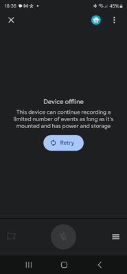

Since subscribing to the googlw home public preview , I have had problems with my nest hello doorbell and now I am at a state where it's unusable as I am unable to reset it as it thinks it's live in Google home and Google home now thinks I have five doorbells none of which can be accessed.
When trying to setup the doorbell it gets to a state where it says to wait for a minute, then it either freezes or fails and says to factory reset the doorbell.
My router shows that a WiFi connection to the doorbell exists.
How can I get the additional configurations removed from my Google home configuration so that I can get my doorbell to work again.
I can't even use the nest app to reset anything.

Did you "transfer" your 1st gen Google Nest Hello Doorbell from the Google Nest app to the beta "Public Preview" version of the Google Home app (https://www.googlenestcommunity.com/t5/Blog/Expanded-support-rolling-out-all-Nest-Cams-can-transfer-...)?
I'm asking because your Nest Hello settings look the same as our untransferred 1st gen Google Nest Hello Doorbells appear in the Google Home app. (We "migrated" our Nest Account to a Google Account in 2020; since then we've had this limited access to our 1st gen cameras and doorbells in the Google Home app.)   If your Nest Hello Doorbell is NOT transferred, you SHOULD still be able to access it from the Google Nest app; I don't know why you don't have access.
I can't tell what has all happened in your case, or why "copies" of your doorbell have proliferated . We've avoided the beta "Public Preview" version of the Google Home app because it's still in "Preview" status after more than 2 years and because the Google Home app still lacks so many Nest app functions (https://support.google.com/googlenest/answer/13038234#zippy=%2Cnest-app-only-features).
It is supposed to be possible to to opt out of the "Public Preview" of the Google Home app, but I don't know if that will take care of whatever is going on with your doorbell, and if you have "transferred" any of your 1st gen cameras or doorbells, you'll probably want to transfer them back to the Google Nest app first.

I think the main issue seems to come from my router linking the doorbell to a different IP when it got reset.
I have now locked down the IP allocation and it seems to be a bit more stable now, but its not in the public preview.
Not going to use that till all my nest devices can be migrated without having to use the Nest App to do any re-installs.
I also still have dormant doorbell configs in google home that do not seem to be removable.
A support rep says they will disappear after a period of time, but I will wait to be convinced.
