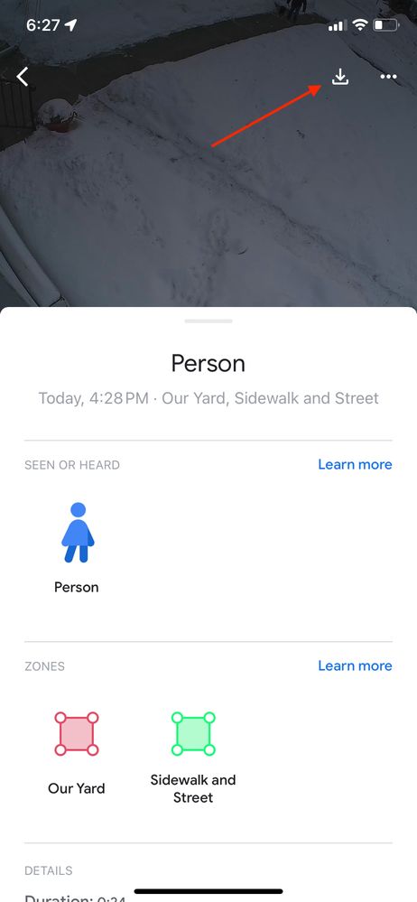

In the iOS version, there is another way to download a clip in addition to the "More" | "Save clip to device" option. Hopefully it shows on your android phone, unlike the "Save clip to device" option.
When displaying an event, click on the "Event Details" button. The screen that displays shows a small "Download" icon in the upper right corner, as in the screen shot below. It's not very noticeable because of all the larger graphics in the white area on the bottom two-thirds of the screen.

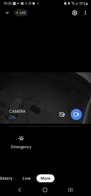

I have this. Notice they look like totally different apps. I chose Google because I would rather use Android related Google products rather than iPhone supported products.
I sincerely feel contempt for this 2nd Gen Google camera. Mainly because it isn't it in my Nest App. I don't like having to go to two apps to pull an event to look at it. Google promised to fix this 2 years ago and they have made no progress. This is the only camera I can't save an event clip.

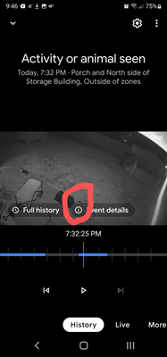

YOU'RE A GENIUS!!!
It's there. I had to go into the history then the actual clip then I to  Events details where the I with a circle is. I had to look for the downloaded clip. Google created a new album called "Movies".
This worked. Google owes you a big paycheck. You have my thanks and gratitude...

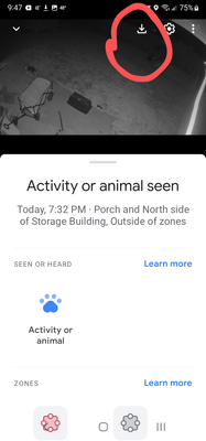

@tiredmomybonn
You're welcome. I should have noticed the "Download" icon earlier, but the big white popup that covers the bottom two-thirds of the screen focuses one's attention there. The "Download" option should really be in that big popup.  (I don't really understand the purpose of the large popup; it shows the same information that is already in the text at the top of the screen.)
There will be no "big paycheck"; I'm just another Google Nest customer posting comments here. Good luck to you; I'm sorry you were told you needed a Nest Aware Plus subscription instead of just a Nest Aware subscription.
Your information was perfect. Initially I didn't see the download button either. My chrome cast options was hovering right over it.
I had to move a little of the screen to get it where I could click on it and the cast icon would go away.
I agree, Google's fix was not a fix. I've had Nest Aware since the time it covered o e camera at a time. When it started covering all the cameras I was elated. But, to have to subscribe to the most expensive Best package should not have been an issue. Since I pay yearly and just resubscribed. I am stuck with it for a year. So I guess I'll just watch continual feeds to see if there is any upside.
Oh another feature of that download button... I can put all of my Nest clips in that Movies download folder and they can pile up in there instead getting that message you get from Nest when the Nest storage folder is at capacity.  I have Google 1 and those clips will get uploaded in that storage space and I won't have to worry about deleting old clips

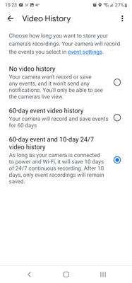

If you go to Settings | Nest Aware in the Google Home app, does it show your Nest Aware Plus subscription?
If you go to your camera in the Google Home app and go to Settings | Video | Video history, does it show your Nest Aware Plus subscription? If you select Video history, is the "60-day event and 10-day video history" option checked?
If so, you should be able to click on History under your live video feed, and then select Full History, and then select an event from those that are shown, and then click on the "More" icon (the 3 dots), and then select "Save clip to device" (see screen capture in earlier post).
I can't tell which camera you have. If you have the Google Nest Camera (Battery) and it is plugged in, you get up to 10 days of 24/7 video history and up to 60 days of event video history; if it is not plugged in you only get up to 60 days of event video history (even if you have a Nest Aware Plus subscription).
If you have the new Google Nest Indoor Camera (the 2nd gen version), you get up to 10 days of 24/7 video history and up to 60 days of event video history.
