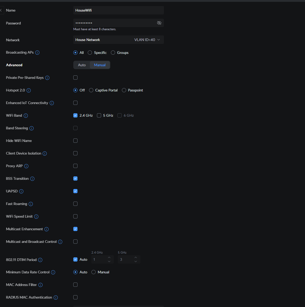

Hi all,
I have 2 Nest protects working on my Ubiquity wifi network without issues.
A 3th one has some issues an i factory wiped him, but i cant get it to reconnect to the Wifi..
The other 2 are working perfectly fine and are reporting back to the app.
The 3th keeps giving me a P006 error.
I did factory resets, i tried setup with my phone connected to the Housewifi, i tried being in Airplane mode connect to the wifi, ....
I dont know what to do...

For a joke i tested the Nest on a 4G hotspot.... worked instantly... i dont get what is wrong with my Housewifi or if it just dislikes Unify
i have 4 other wifi's running. it refuses to connect to either
