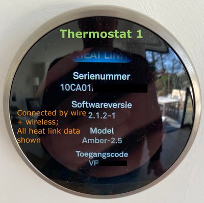

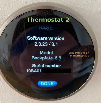

Thanks @DragosC and @Frustratedddd for your replies. Both thermostats showed different access keys for the heat links.
Followed @Frustratedddd process (more or less), by first trying to establish wireless connection as well (fails), next I did a full reset (same situation) and finally rest the heat link connected to Thermostat 2. After the reset, thermostat 2 was only connected by wire, but whole system worked as expected (issue solved).
Attached screenshots of the thermostat's info, main diff: Thermostat is connected by wire + wireless, and shows more info for heat link (thermostat 2 only showing entry key).
Thermostat 1Thermostat 1
Thermostat 2Thermostat 2Thermostat 2Thermostat 2Thermostat 1/2Thermostat 1/2

Double checked the connections for both thermostats:
- Thermostat 1 (assumably controlling both heat links) is set to wired and wireless, and gives me details for 1 (!)  heat link
- Thermostat 2 strangely is (now) set to wired only - and does not give me any details for a heat link (only access hash)
