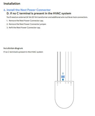

@Brinbfr
You must purchase the Nest Power Connector to use the Google Nest Thermostat with your system.
Then wire it like this.

Thanks Patrick
I did buy the nest power adapter, but could not find the use case that you sent me above, which matched exactly what I was looking for.
I installed per this diagram and instructions and the Nest is functioning properly and no more equipment errors.
THANK YOU
