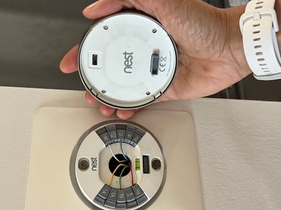

Hello Derick
Thank you for helping me out, apologies for the delay, this device is in my parents house and I’m just at their house now.
The device is a Gen 3, and not finding a code for linking to the app.
I have completed a full factory reset, reboot afterwards in attempts to try other routes.
I also rebooted the phone, deleted the nest app and started over, still the device will not show a connection code.
My dad is using the Nest app, when we tried google home app, it said to use nest for this generation device.
I’m attaching the picture of the error message, sorry it’s in Spanish.
Thank you for your help.

Derickf
Hi there!
Thanks for your reply. I appreciate all the relevant information you shared, including the troubleshooting steps you have tried so far and pictures of your Nest Learning Thermostat. After viewing the pictures you shared, I was able to determine that you have a Nest Learning Thermostat (2nd gen).
The reason your thermostat is failing to connect to your account and is not issuing a setup code is the end of support for the Nest Learning Thermostat (1st and 2nd Gen), which began on October 25th. This means these models can no longer connect to the Nest app. While your 2nd Gen model can still be used manually, remote app control is no longer available.
