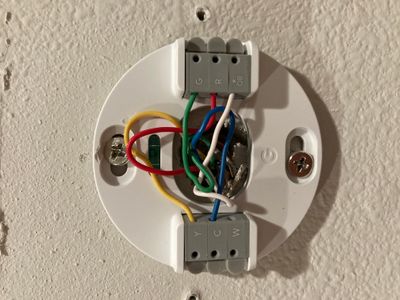

NestNestOld HoneywellOld HoneywellWiring Config on the furnaceWiring Config on the furnaceI have gas furnace and heat pump(AC unit). I think my wiring is correct based on my own research. But the AC always kicks in, and I had to shut off the breaker so I can get hot air. I've tried switching O/B and W wire, and it didn't work.

I have no heat pump but that’s how I got mine setup
https://www.flickr.com/photos/80134125@N04/shares/554g14
Thanks for sharing! I gave up and switched back to the old Honeywell thermostats

I had the same issue, we tried changing setting but what worked was disconnected the nest from the wall and then re-attaching it. It started working correctly.
SBDawg
I've tried that many times, and it didn't work.
