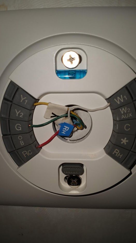

horseshoehorn
This is how it was wired.
horseshoehorn
This is how it is now wired per Patrick's suggestion.
horseshoehorn
Because the problem is very intermittent, I am still evaluating if this solution works.
