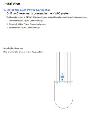

The thermostat terminals on a Taco Valve Controller typically are looking for a switch closure (like a light switch).
You'll need an external 24Vac transformer and the Google Nest Power Connector.
This is an example of how it could be wired.
