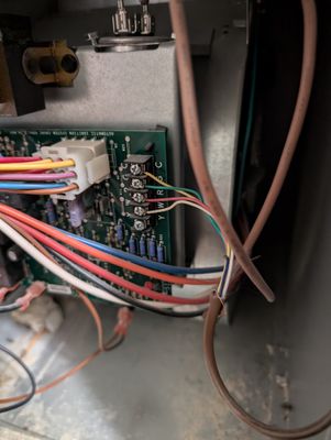

I'm trying to connect my Nest thermostat. I bought it because it doesn't need a C-wire. The Nest Power Connector is basically the same thing.  I rent an apartment and they don't allow c-wire installation. Probably because the wiring on the board at the HVAC unit is connected to R, G, W, and C, but not to Y.
Do I have any options besides returning this?

Can you post a picture of the original thermostat and the HVAC control board wiring here.
I am trying to figure out how to post images here.
JasonM1
JasonM1
JasonM1
There is an unused blue wire at the thermostat, but it has been cut somewhere along the way.

@Ashepherdson, Thanks for your input. I also appreciate all the information you've provided, @JasonM1. Based on the pictures, it seems you have a common wire installed on the control board, which is the yellow wire. To provide the most accurate guidance, please confirm the following:
  • Do you have a heating-only or heating and cooling system?
  • Could you please share the make and model of your HVAC system?
Please keep me posted.
Jenniffer
It's heating and cooling. The yellow wire on the C terminal is not the same yellow wire as the one at the thermostat.
