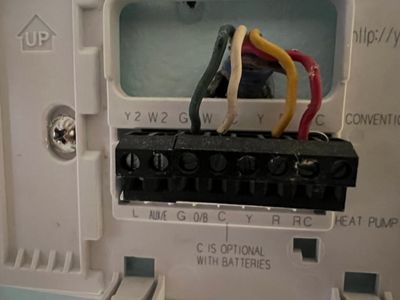

My nest thermostat only has 2 AAA batteries for power with no internal backup batteries and and no C wire connected. I’m concern about the batteries failing when I’m not there and the air conditioner not coming on. I have a question regarding the use of a C wire. I live in a condo, my blower unit is location in the ceiling of condo but the rest of unit in on the building roof about 50 feet away. My air conditioning guy said he would have to run a C wire from both piece of equipment at a huge cost.  Is there any other methods I could use. I have read a few methods like adding a 24 volt transformer C wire adapter or using green (fan) wire. Any advice or links to websites with solutions that wouldn’t damage the air conditioner or thermostat would be greatly appreciate.
@Sierreone , can you get a picture of your thermostat so I can see the wires that are currently coming to it and I’m curious to know if there any conductors that are tucked behind the wall that are still available for use.
AC Cooling Wizard
This was the old thermostat
 and this is the new Nest thermostat
From what I can see there are no other wires
The Nest Learning Thermostat has the ability to use a sort of back door to reach the Power Common. However the basic Nest thermostat you purchsed does not have that ability.  You can use a Nest Power Connector.  This requires you update the software on the Nest Thermostat, then installs the Nest Power Connector.

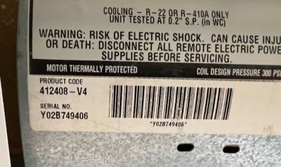

Can you get the manufacturer and model number of that unit so I can look at the documentation.
AC Cooling Wizard
This is all I can get access to, can’t seem to find original documents.
