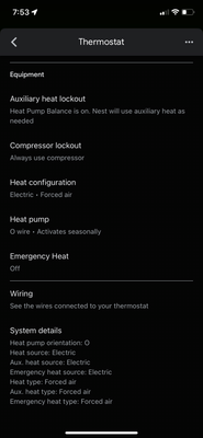

  • Do you see any message or code that appears on the thermostat or on the app? C wire not detectedIMG_2848.jpgIMG_2849.jpgIMG_2850.jpgIMG_2852.jpg
