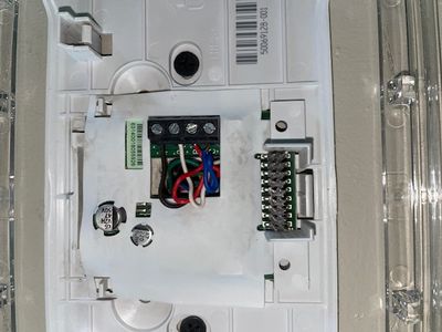

I finally was able to get a picture. From top down: 1, 2, R, C

Hi again! @melika,
Thanks for the photo provided; I'd be happy to help you with your compatibility concerns!
We're happy you're considering Nest Thermostat. I noticed the numbered labels on your photo suggest a proprietary system. Unfortunately, Nest Thermostats are not compatible with these systems, as they typically only work with thermostats made by the same manufacturer.
If you prefer, you can contact a local professional to see if your proprietary system can be rewired to be Nest compatible.
For more information on thermostat wire identification, refer to this article: Identify a thermostat wire.
Let me know if you have more questions.
