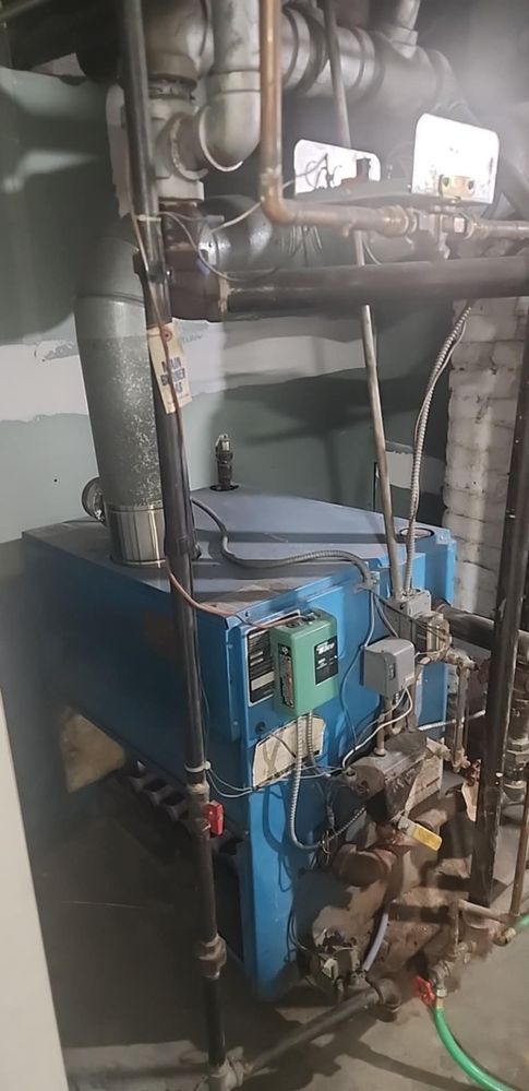

I recently purchased the 4th generation Nest thermostat, but it occasionally displays an error message for about 2 to 10 minutes. While this doesn't bother me too much since the heat eventually runs again, even if I'm away from home, it does happen sporadically—sometimes daily or weekly—even after recharging and removing the thermostat.
The main issue is that sometimes the system does not start, even when the thermostat is set to a high temperature. Although the thermostat remains powered on, the Vin reading drops to just 6.4V. The system only works again after removing and reconnecting the thermostat.

System Details:
  • Boiler: Water steam heater with radiators powered by gas (blue color). - heat only
  • Wiring: Two wires connected — White (W1) and Red (Rh).
  • Vin (Thermostat Device Info): 6.4V or lower.

I have a customer with this same issue.  The Nest Power Connector solution will not work in a heat only 2 wire scenario.  Also it will not work well without a circuit board and would require an electrician to hard wire this power connector.
The Nest gets power, connects, then the Nest complains about no power.  So, I agree it needs more power.  The ideal solution is a 24 Volt transformer pugged into the wall outlet by the t-stat.  Connect one line to the Rh and the other line to the C for the common wire.  This all sounds good in theory, and since Nest does not make this, will it work?  Otherwise in all scenarios, since all models of the Nest we tried without a "C" wire will require the "c" wire.  The house was built in 1920.

"I've installed an AC 24V Transformer (C-Wire Adapter) by connecting one wire to the C terminal and the other to Rc. Previously, I connected the white wire from the boiler to W1 and the red wire from the boiler to Rc. Everything seems to be working fine so far."
