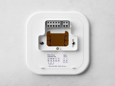

I have six gen 1's in my house. Can I replace them with the tado theromstat X? Would they fit on the same mounting panel on the walls?
12 REPLIES 12
Rwiinbo
Hi! Well, the dimensions of the 1st generation Nest Thermostat are 3.3 inches in diameter and 1.07 inches deep, while the Smart Thermostat X has dimensions of 3.93701 x 3.93701 inches in diameter and 0.826772 inches deep. You can order without any problem, but you would have to make a little more space at the base.
It should be noted that the first-generation Nest has reached its update limit after 10 years of use and will only function manually, as it will no longer be accessible through the app. I hope this information is helpful.
Rwiinbo
pw1976
Ok understood but does it plug into the same backplate as the gen 1? I.e., is it compatible?
Rwiinbo
No, while the base of the first-generation Nest Thermostat is round (in fact, all of them are), the Smart Thermostat X has a square base. The bases are different, so even if you try to adjust it, unfortunately, it won't fit properly.
