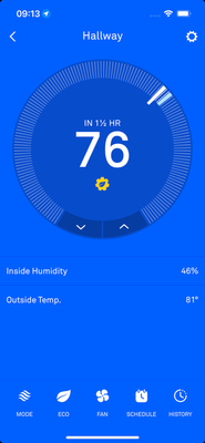

 my AC had been running since last night at 8:00 pm and it’s not almost 10:00 am next day and it has only dropped one degree I normally have house set to 76 but it is not lowering past 78 and keeps saying 2+ hours to cool. Is anyone else having this issue or has had this issue because I’d really like help. I’d also like to add we replaces the filter last week along with i just hoses down AC unit this morning and it’s still not cooling. I decided to turn it off rightnow because I already know my bill is going to be so high.

It appears that these are power-related issues that might happen when the system isn't sufficient enough to meet the target temperatures; either the current temperature is too hot or too cold, or there is also a Rush Hour Rewards and Seasonal Savings feature enabled.
Do all your Nest Thermostats have common wires? If so, check the power readouts in its Technical Info settings or in the Equipment settings. In addition, based on the picture posted above, please check out these articles and let us know if you have more questions.
