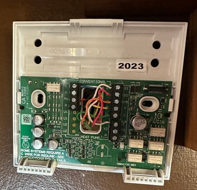

  • I just installed a 4th gen Nest.
    I have it set on cool but hot air is blowing out.
    I have hooked up W1 and W2 aux. is that the problem?
@Pcamacho ,
your system is a heat pump base system, and you did not hook up the orange wire properly. The orange wire goes into the OB terminal and the white wire goes into the W2 terminal.

@Pcamacho
Post a picture of the original thermostat's wiring here
I do not have permission to upload images.
This is how I connected the Nest:
I did it. Here is the picture of the old thermostat.
@Pcamacho ,
AC Cooling Wizard
That did the trick!
Very much appreciated.
