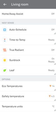

Having read numerous posts on here yesterday - I turned off home/away assist and manually restarted the heatlink and the thermostat - but same result today
Any suggestions most welcome
