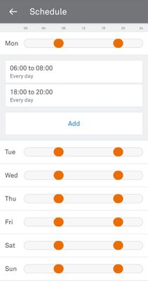

Can you explain why my heating is coming on the the hot water does? The hot water is on a schedule but I just want to be to turn heating on and off with no schedule
DragosC
Could you please provide us with a picture of the hot water's schedule?

Sorry can't figure out how to attach a photo. Just to say it seems when the hot water comes on it diverts some heat to the radiators. Is this normal?

AlexD
Thank you for the screenshot. Just to clarify, at the point when the hot water is activated, based on your schedule, your heating also comes on, correct?
