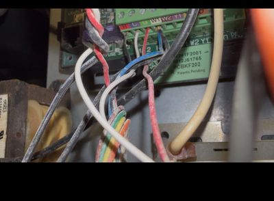

Help Gen 4 Nest replacing a Comfort net thermostat. Only has wires 1, 2, R, C
Seb21
 top photo is the thermostat. Bottom photo is the control panel.  Top to bottom 1, 2, R, C
any ideas which wires plug into the nest hub ports ?
thanks

Hi Shel,
Thank you so much for your response.
When looking at my wires there is current no yellow wire:
Just
Black
White
Blue
Red
Derickf
Hi @Seb21,
I appreciate you taking the time to post in the community. I can totally answer the question you have about compatibility with the Nest thermostat. As I can see from the pictures you provided, your HVAC system seems to be a proprietary system, and it is not compatible with the Nest thermostat.
