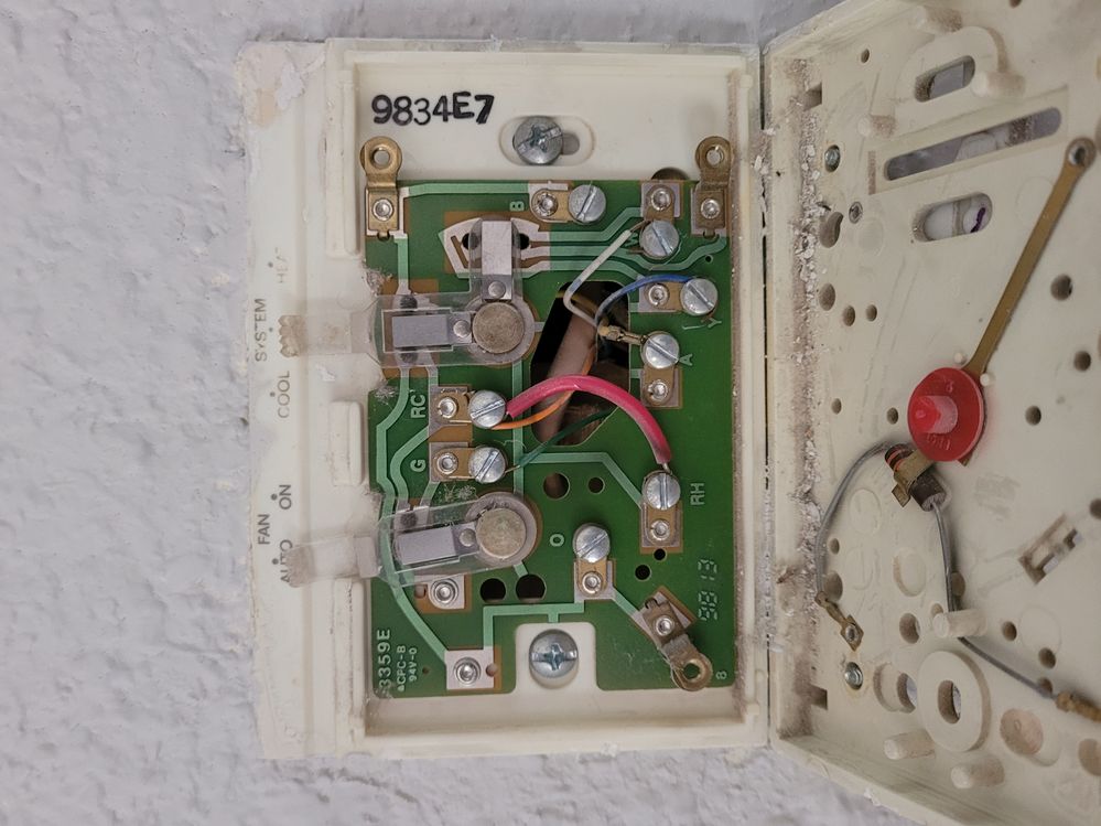

Help, Will my current wiring work with the Google Nest Learning Thermostat
Mrtayto
Yes, your current thermostat is compatible with the Nest 3rd Gen Learning Thmerostat.
Give this wiring a try.
Orange - RC to Rc (jumper to RH not needed)
Green - G to G
Blue - Y to Y1
White - W to W1
You might have some problems with the cable that was used. The terminals on the base don't always grab the thin wires from a data cable.
