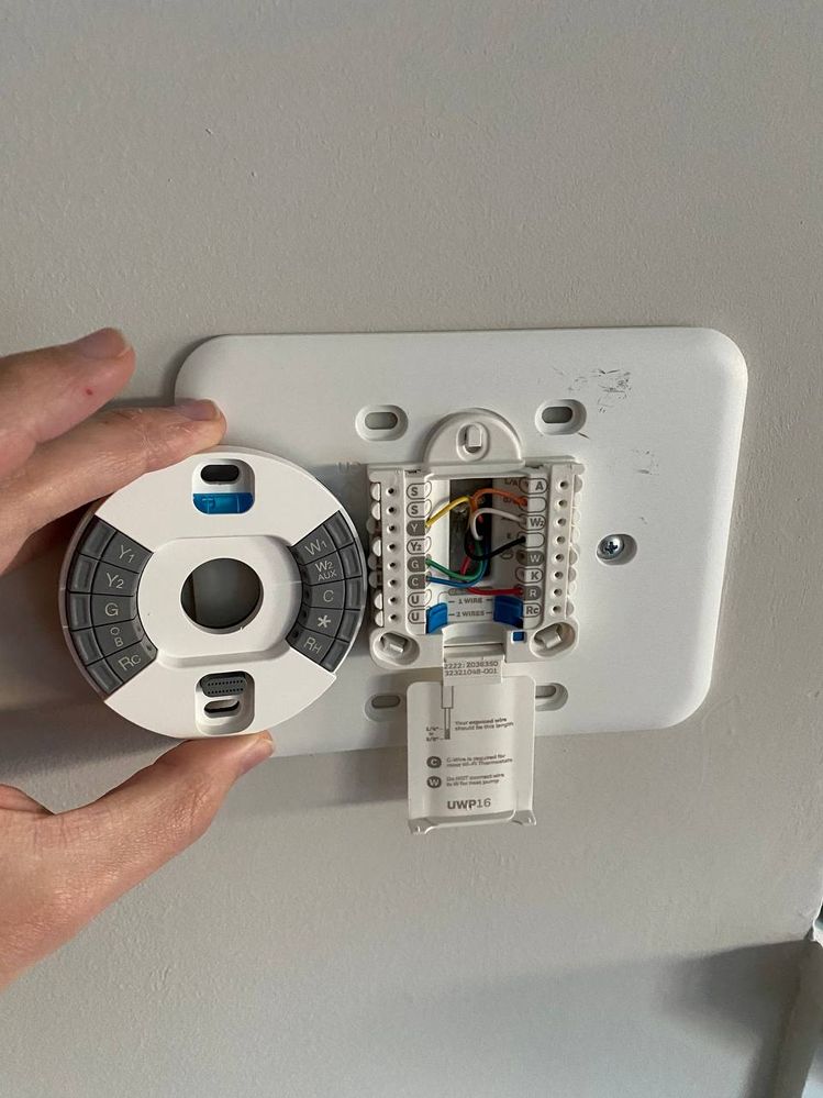

Hi, hoping you can do a sanity check with me and check my wiring. I'm prettry sure about all of them except the black (E) wire. Where should that one go? *?photo_2022-11-27_10-53-15.jpg

What is the brand and model number of your indoor and outdoor unit?
Is this a heat pump and do you know what the backup heat is? Is it electric coils for backup heat, or a gas furnace that kicks on if the outside temp gets very cold?
Something is strange because they do not have any wire going to W aka W1 which is usually for the main heat on the old tstat, they only have it going to W2 which is usually for 2nd stage heat in a two stage heating furnace.
The black could be for a humidifier or dehumidifier if there is one in the duct near the furnace.
