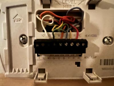

How do I map these wires?

Please provide some details on your hvac system (heat pump etc)
theguy1
well it looks like you don't have a c wire which may cause some problems with your nest. but the nest will still work but will limit alot of features. That c cable with your R cable gives it 24v to the nest so it can stay charge
Yes, your current thermostat is compatible with any of the Nest thermostats.
I would suggest wiring it like this.
White - W1 to W2/AUX or W
Green - G to G
Orange - O to OB or */OB
Black - B to C
Yellow - Y to Y1 or Y
Red to Rc or R - jumper to RC not needed
The "or" is for the Google Nest Thermostat
