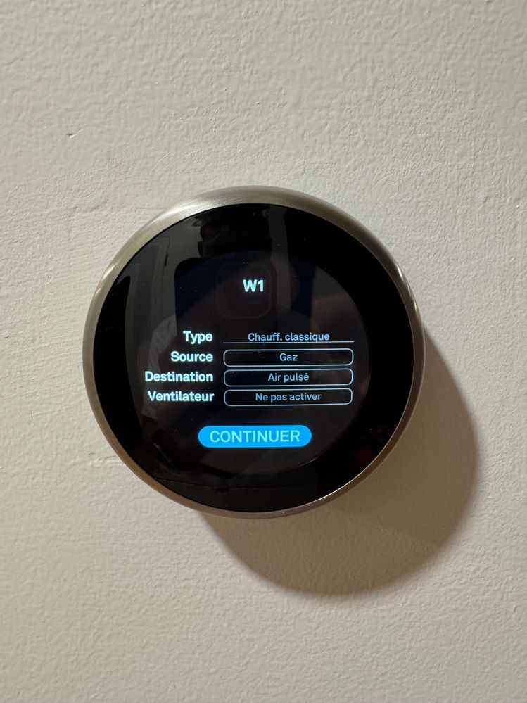

I have a rather old heating system, electric furnace Nortron 21B20, which works as W1 or W2 (i.e. has two heating stages) and in summer, can only work as ventilation (G). When I connected all the wires as G->G, W1->W1, W2->W2 and R->R, during the W1 heating test, the thermostat showed that it will run as (G,W1), although I only want it to run as W1. I have no option in the settings to disable ventilation when setting W1, although the manual has this option.image.png

Thank you for your reply. Unfortunately, this cannot solve my problem, because when selecting the type of heating furnace as electric, the option with fan off/on is not available. The only way I have found is to change the furnace to a gas, then the option with fan is available. This is a very strange solution, why is it only available for the boiler type with gas?
Anyway, I changed the settings yesterday, selecting boiler type with gas and with fan disabled and it works fine, finally the fan does not run on third speed and it's fine!
Still I have a question : is there any way I can set the electric boiler to work with the fan disabled? If not, can I leave the boiler type as gas boiler in my case? Will this not change the logic of the thermostat itself?
