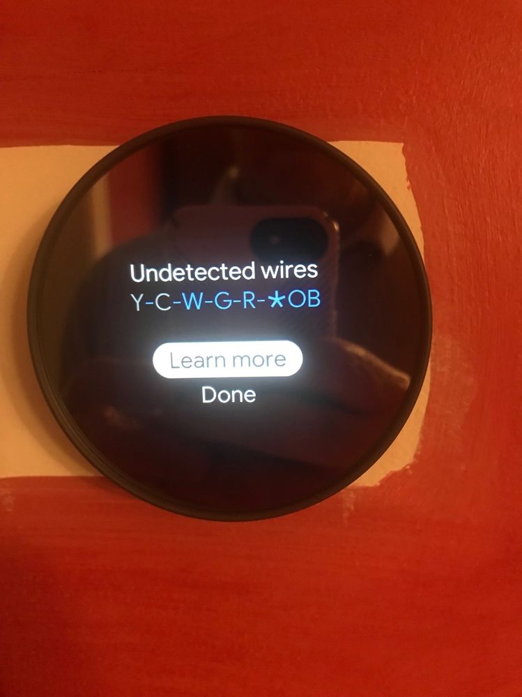

I have a two zone system. The Main Thermostat on the first floor and a secondary on the second floor
mjm01833
I can hear the main furnace kick on and it blows cool air but the outside AC condenser doesn't come on.
6 REPLIES 6
It looks like your current thermostat is not compatible with any of the Nest thermostats.
You have both an O and B wire and none of the Nests are compatible when both of those wires are present.
Sometimes a B wire is used as a C wire, but this isn't the case this time.
Ok Thank You. So even a Nest Smart Thermostat will not work?
Nope, I don't know what other brand might work.
