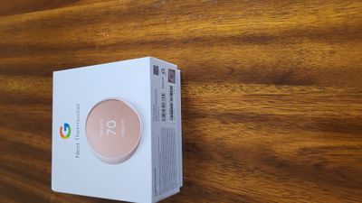

here are pictures of original and Nest wiring and product box. I see where you are supposed to choose either O orB, but I don't find that option in Nest.
but I don't see that option on the Nest

Hello Spmarg,
Thanks for getting back to us. I checked your thermostat wires and how you connected them to the Nest Thermostat, and I found that the Nest Thermostat you have is the Nest Thermostat 2020, which is not compatible with your thermostat wires but is compatible with the Nest Learning Thermostat 3rd generation. Therefore, you should be wired your thermostat wires to the Nest Learning Thermostat 3rd generation base as follows:
  • Yellow wire to Y1
  • White wire to W2 Aux
  • Green wire to G
  • Black wire to C
  • Orange wire to OB
  • Red wire to RH

No, I do not need anymore help. I will return the Google Nest as it is not compatible with my heat pump system.
