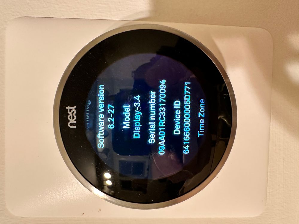

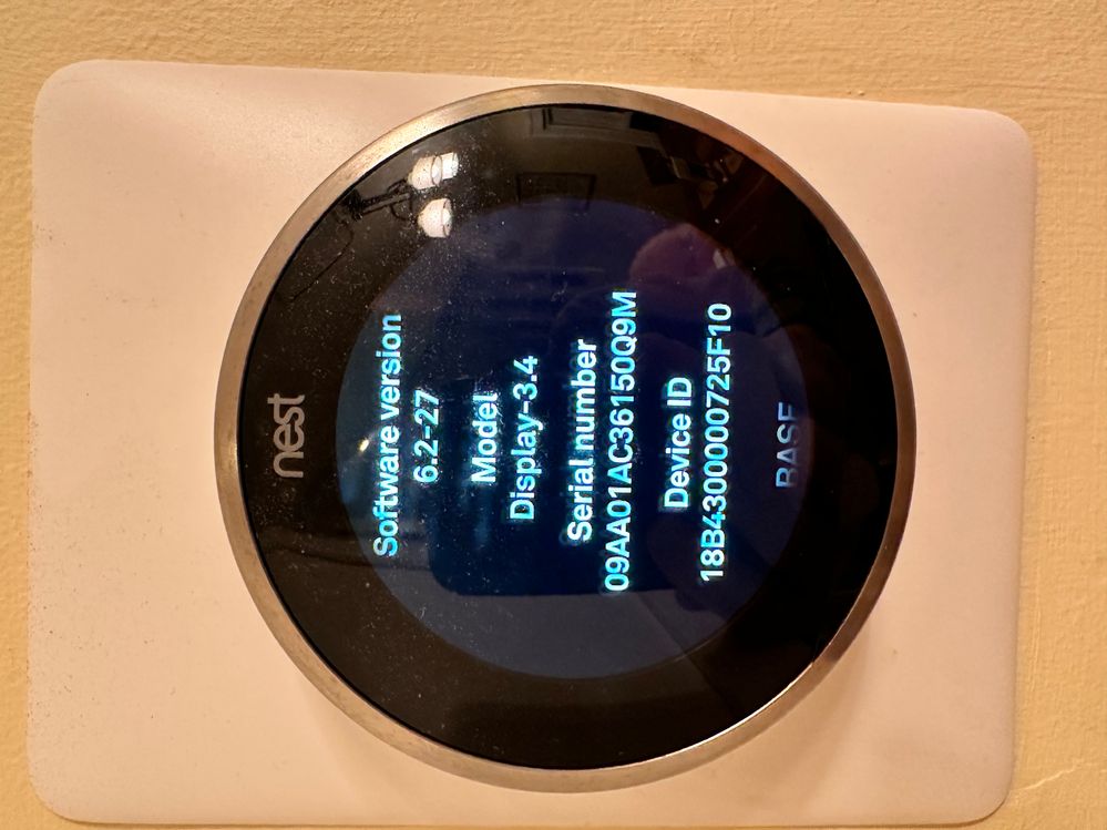

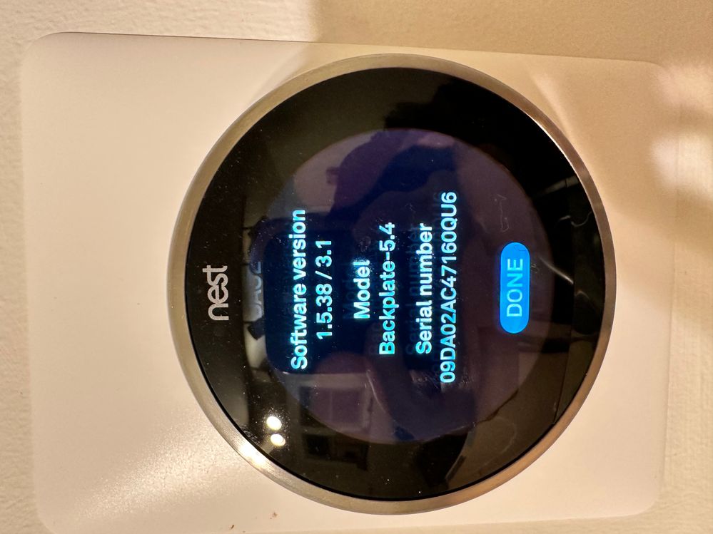

I have two Nest Learning Thermostats for two zones of heating.
Both hooked up with just the Rc and W1 wires. They have worked for 5+ years. But now one of the two is showing low battery. I am getting 24VAC on both setups. I enclose the version info for the two thermostats. Why is one working and not the other? The Backplate 5.3 one works and the Backplate 5.4 is the one about to shut down for Low battery.
