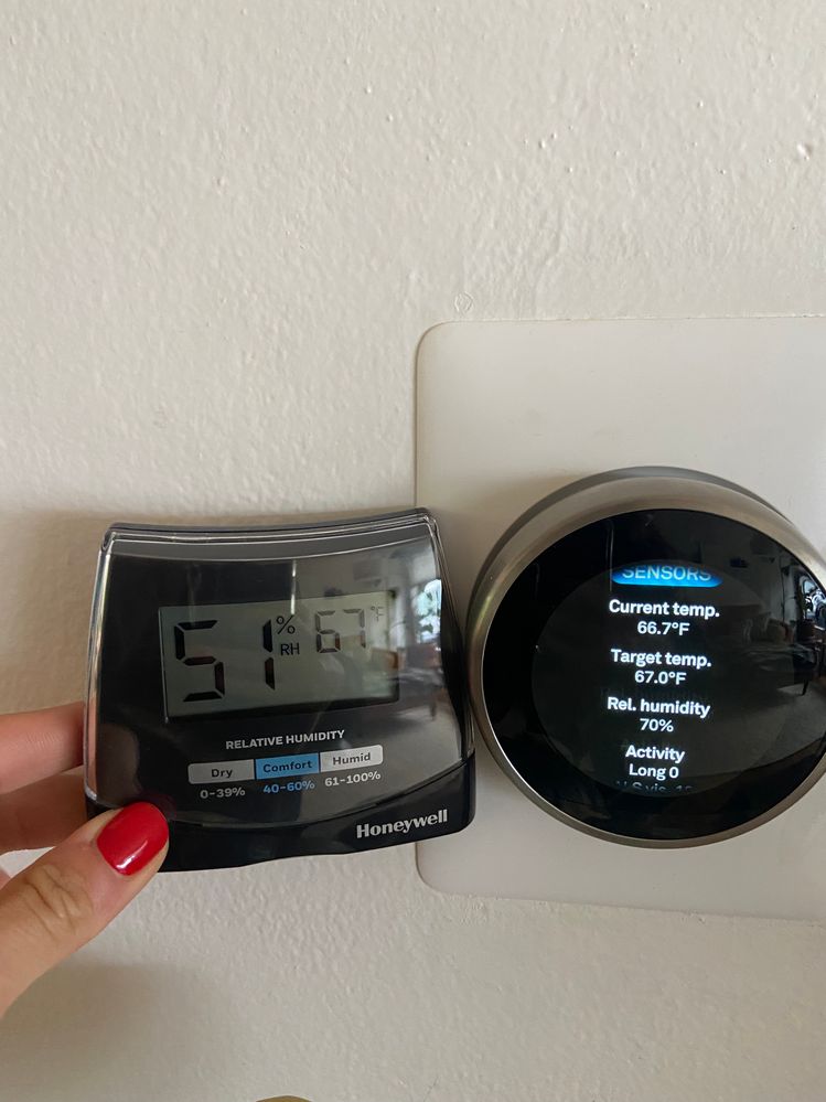

Has anyone had any issues with the Nest Thermostat showing incorrect humidity values? Mine is constantly saying its around 65-70% RH but I bought a humidity monitor and its reading under 10% RH below what the Nest says. I've tried restarting and resetting the nest to factory settings but I still have this issue.

I am having the exact same issue. best showing RH 65-70% , so I bought two independent RH meters which both show 55% when testing throughout the home.  I wonder if it’s an update software glitch as I don’t recall Nest showing questionalbale levels previously.

91% vs. 47%91% vs. 47%I have the same issue.  We just got a Nest installed with a new HVAC and natural gas furnace on April 14th.  The humidity reported agreed with 2 other humidstats I previously owned plus the dehumidifier in our basement.  Starting about the time this software upgraded (May 3rd) the humidity reports are way too high.  See the photo but basically it is high 40%.  Something is clearly wrong with this software version.  Google/Nest, can you please comment?
Model Nest Learning Thermostat Display (3rd Generation)
Backplate model Backplate-5.26
Software 6.2-27
Updated May 3, 2022 2:03 PM
Last contact Just now
Battery 3.92 volts
bdk1
I ended up opening a support case with Google via this URL last weekend:
After working via a chat session for nearly 2 hours the support technician offered I could return the thermostat to the store for an exchange or open a warranty claim with Google.  I opened a claim and have since received and installed my replacement.  It has been showing humidity readings consistent with my humidistat and has upgraded itself to the latest software version (6.2-27).  Once I return the defective unit and Google refunds the replacement cost (they hold the amount on your credit card) I hopefully will be finished with this issue.  In any case, my problem appears to be a hardware failure on a thermostat that was installed just less than 2 months ago.
