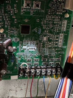

I wired the Nest Power Connector in accordance with the "Cooling and Heating System" diagram, but the outdoor AC unit won't kick on after the installation. The current wires at the furance board before installing the power connects are: W2 and W1 (jumper), W1 , R, G, B/C, Y1 and O(jumper). The bold letters are connected to the thermostat. I left the W1 and G wires untouched, and connected the R wire from themostate with the gray R wire of the power connector, and the Y1 wire with the gray R wire of the power connector. The three white wires from the power connectors were connected to the C, R, and Y1 at the furnance board. However, the outdoor AC unit won't kick on after the installation. Any help would be much appreciated. Thank you!

Thank you for your response. I followed the Nest Installation Guide for "Cooling and Heating System" when I added the power connector. Below is the pictures of the "Before" and "After" wiring the Connector.
Before:
After:

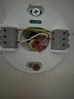

Post a picture of the original thermostat's wiring here if you have it
@Patrick_Caezza
Hi Patrick - appreciate your response. Here are three pictures: Thermostate Wiring, The wiring at the furance board before  installing the Nest Power Connector (NPC), and the Wiring of NPC.
Any thoughts/suggestions?
