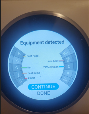

Additional info:
Model: Nest Learning Thermostat, 3rd generation
Wires:
Wires Detected:

gb1123
Hello @ovidioj!
Swapping from O to B solved the issue. The air is now blowing cool again.
Thank you so much.
