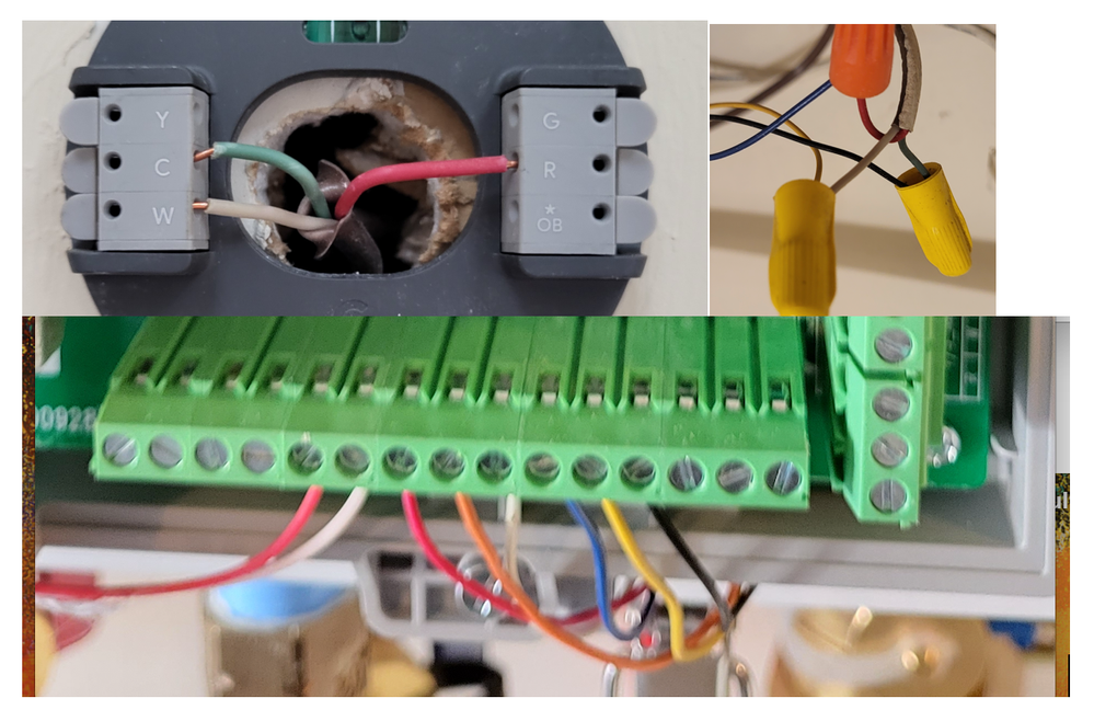

I recently have my heating and hot water systems replaced with Navien NCB-190/060H(NG) combo system. My old Nest thermostats, used to work very well with the old system, don't turn off with the Navien. They heat up but refuse to turn off, I have to unplug the Nest from the wall base to turn off the heat. Any suggestions/recommendations appreciated. Below is a picture of the Nest connections.20221002_102130.jpg

Post pics of the connections at the combo unit. Where are they wires connected?
aa54
Thanks. Here are a few pics.
Please note that R, W, C(green) on the thermostat end (top left) are swapped to Blue, Yellow, and Black in the junction box (top right). In the combo unit (bottom picture) these three connections are visible towards the right side.Image2022-10-18.png
Looks like correct wiring at both ends.
Did you tell Nest it was a radiator system, and not a hot air system?
All the Nest does in this system is conncet Red to White like a switch, When it wants heat it sends 24V from the red wire to the white wire.

I only see one set of thermostat wires connected to the Navien. You said there are 2 in this system. Do you know where the 2nd thermostat wires connect?
The Navien has 2 sets of screw terminals for 2 zones but you are only using one set.
If you look in the manual for the Navien it will show how to wire 2 thermostats to the terminal strip screws.
This might be why it is acting erratic if they wired the 2 stats in series.

You caught it, clever eyes....the upstairs Nest is now replaced with a traditional thermostat until we can make downstairs work
OK just make sure each tstat goes directly to the Navien to the correct screws for each zone.
Nest should work in this system it is very basic setup not sure why you are having problems.
