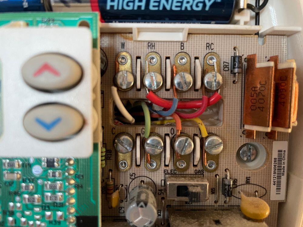

Looking to install Nest thermostats.
We have a zoned system  Maytag M1010 Series 90/92 AFUE HE Furnace / 12 SEER HE A/C with a DuroZone SMZ-SW Zone Control System.
There is one master thermostat with W, B, G, O, Y, RH to RC wires and two other thermostats with W, Y and R (B & G present, but not connected) .

IMG_1276.jpgimage0.jpegI have wired the Learning Thermostat as per your specifications and there is no power to the thermostat - please advise...

Does anyone have a solution to "no power" to the nest with this wiring?
There is one master thermostat with W, B, G, O, Y, RC with jump wire to RH
I had one person answer my original question, but no response after trying the wiring suggested:
“Thanks for posting here in the Community forum and for showing interest in our Nest Thermostats. Fortunately, your thermostat wires are compatible with our Nest Learning Thermostat 3rd generation only and should be wired to the Nest Learning Thermostat base as follows:
W wire to W1
B wire to C
G wire to G
O wire to OB
Y wire to Y1
RH wire to RH                     (There was only a jump wire I removed, no standalone RH wire)
RC wire to RC
Following these instructions, there is no power to the Nest thermostat.
Eyewalk
There was no power to the thermostat with the above wiring.  After chats with a couple of support people at Nest, it was determined that my system is NOT compatible with any Nest thermostat without a C wire or 3 power connectors (one for each thermostat),  either of which would need to be done by an HVAC specialist.  I have returned the Nest thermostats to the electric company.
