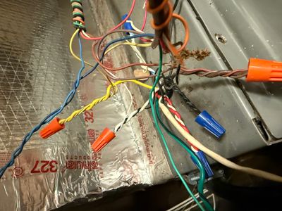

I have 7 wires, as noted below, in the following slots:
  • Yellow in Y1
  • Green in G
  • Blue in O/B
  • Red in Rc
  • White in W1
  • Black in W2/Aux
  • Brown in C
The wiring diagram on my air handler only shows 6 wires, and no diagram on the Nest instructions match my color wires, which is where more confusion came in.

hoping these help!

Thank you for posting in the community. I'm sorry to hear that you are receiving heating instead of cooling after a factory reset on your Nest Learning Thermostat (3rd gen). I appreciate you confirming the troubleshooting steps you have taken and the picture of the current wiring on your Nest Learning Thermostat (3rd gen). I’m happy to help.
To gather the necessary information, please answer the following questions:
  1. Is your HVAC system conventional, or do you have a heat pump?
  2. Could you please take a picture of the control panel of your HVAC system?
I'll be waiting for your reply.
