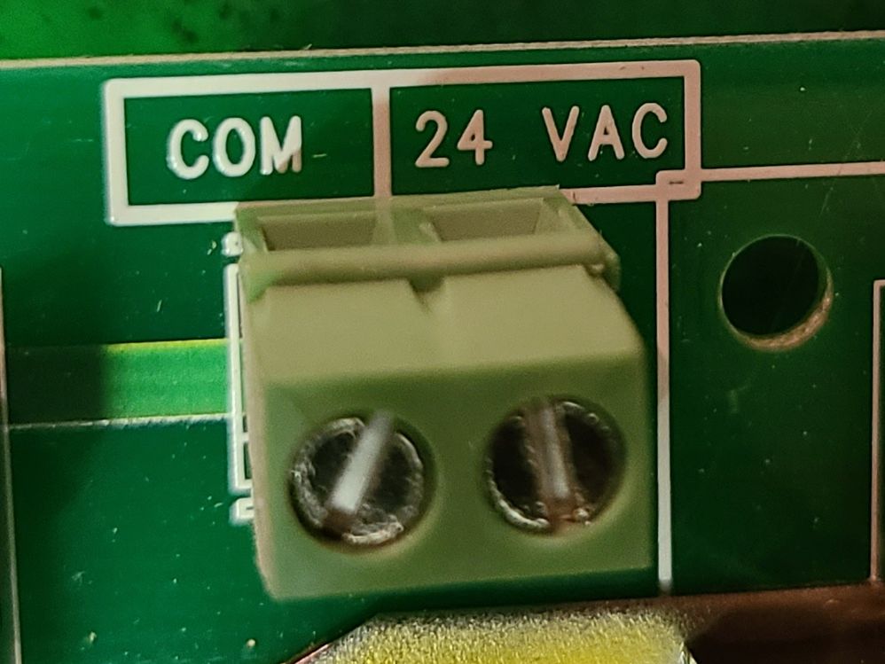

Could use some assistance. Installing these is not always as easy as expected. I have a multi-zone Taco SR506-ESP switching relay. I have 5 zones, but only need to control 3 zone with new Nest thermostats.
I do NOT have the required C wire at each location and can't run new wires to the units. I have a couple of questions:
  1. Will I need a separate Google Nest power connectors for each zone?
  2. Can I connect all 3 "C" wires into the 1 "C" block? I don't see 5 separate "C" blocks on the relay.Taco SR506-ESP.jpgC block close upC block close up
Your experienced guidance is greatly appreciated!
Thanks!

Now I just need to determine if the Taco SR506-ESP switching relay has a "C" block fo each zone.

Based on the above, I understand I need separate Nest Pwer Connectors for each zone.
The last dilemma is identifying separate C blocks. I think I have located them. See attachments.
 Does this look correct?
RenzJ
@Shamrocks24, I'd like to jump in here and see how I could help. To avoid confusion with the wiring, a wiring diagram would help you locate the correct terminal for each wire. If you do not have it on your HVAC cover or control board front, it might be on the user manual for it.
If you´re still having a hard time locating the correct terminals, we suggest you contact Nest Pro to help you out with installation.
