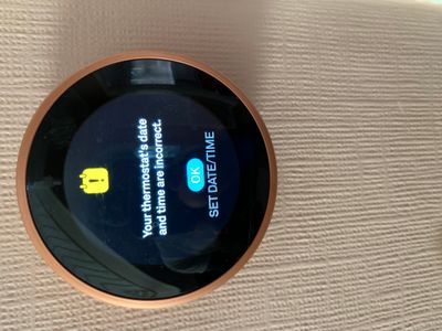

YvesU
Please Help!
Hi my google nest leaning 3rd gen thermostat has stopped working,  I have tried all the factory reset as advised on the nest troubleshooting page and it’s still not responsive checked the power and it has 240 v in and out. It’s been a whole week now!
serial- 09AD01AC37200283
 it shows this and when I go to set the date it says restarting will be back in a bit and just turns off it’s driving me crazy please help
