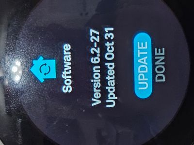

To be sure, can you share with us a photo of your old thermostat and Nest Thermostat's wiring setup? Also, gather the power readings in the Technical Info settings and its Software version.
Sorry about the delayed response.  It goes blank and unresponsive for about 1 min then goes to the "G" screen, the colors spin then shows the temperature.  Stays on for approximately 2 mins then restarts.  I've checked for software update and tried to run tests but can't get past the two minute mark.

Photos below
